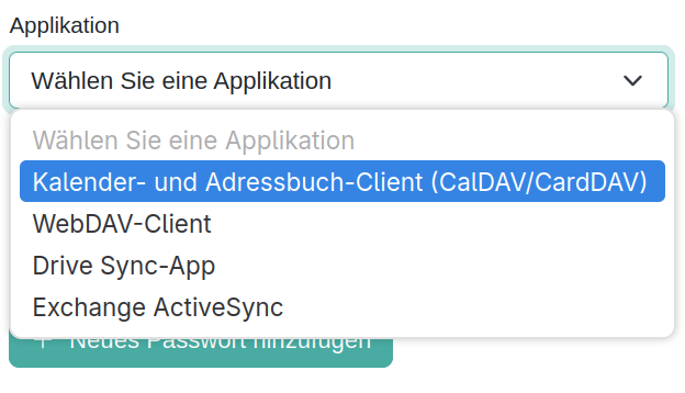

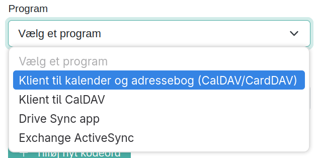

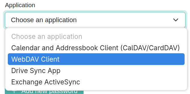

Hi Lars,
that's curios - but maybe just a wrong translation. You're using Dansk language, aren't you?
If we compare the screenshots of German, English and Dansk options we see some anomaly in the second option. In German it is "WebDAV-Client", in English "WebDAV Client" but in Danish "Klient til CalDAV". Any other option is the same (beside localisation differences).
So I would assume you need to set up an application password of type "Klient til CalDAV".
If this is working you may want to file a bug report to mailbox.org to fix the Danish localisation.
With kind regards, Ralf

Hi Ralf,
thank you for sticking with this – your observation about the Danish translation turned out to be exactly right.
The option labelled “Klient til CalDAV” in the Danish UI does indeed work as a WebDAV application password. Using that, I was finally able to authenticate successfully against:
https://dav.mailbox.org/servlet/webdav.infostore/Userstore/
A direct PROPFIND test with curl returned a valid 207 Multi-Status, confirming that authentication and access were working.
From there, the remaining issue turned out to be on the client side. rclone consistently failed or hung unless I disabled HTTP keep-alives:
--disable-http-keep-alives
With that in place, I now have a fully working setup using rclone bisync between Mailbox.org Drive and a local directory.
Final working setup:
  • WebDAV endpoint:
    /servlet/webdav.infostore/Userstore/Lars%20Christensen/
  • Application password type:
    “Klient til CalDAV” (Danish UI)
  • rclone:
    Requires --disable-http-keep-alives
  • Sync mode:
    rclone bisync with --size-only
Test results:
  • Authentication: OK (curl + WebDAV)
  • File listing: OK
  • Full initial sync (~500 MB / 2300 files): OK
  • Handles Danish characters (æ, ø, å) and spaces without issues
So the root causes were:
  1. Misleading Danish translation (CalDAV vs WebDAV)
  2. HTTP connection handling between rclone and mailbox.org
Your hint about the translation mismatch was the key that unlocked the rest – without that, I would not have revisited the application password type.
Thanks again for your help and persistence.
