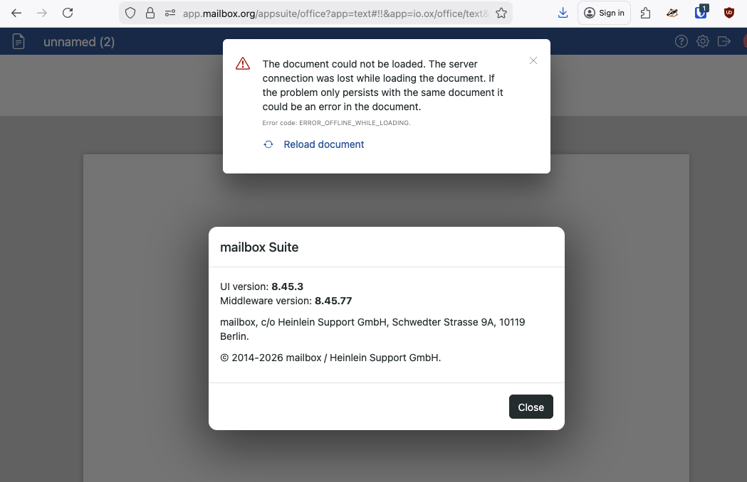

> A window will then open in which you will see an ox number (e.g. ox91) at the very end of the last line
A year later, I'm not seeing that any more. Is there any other way to get those details?
